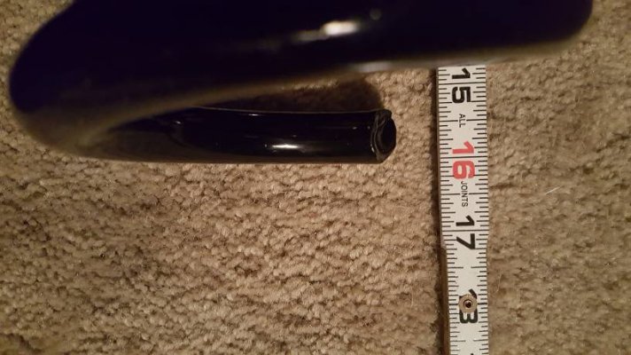

Haven't gotten them installed yet. Dropped them off at the 4wd shop bout 15 mins ago. They are ordering me new oem strut top mounts and stuff so everything will be brand new I install. I really don't wanna touch the suspension once I'm done with this for a while, aside from upper control arms and normal maintenance.

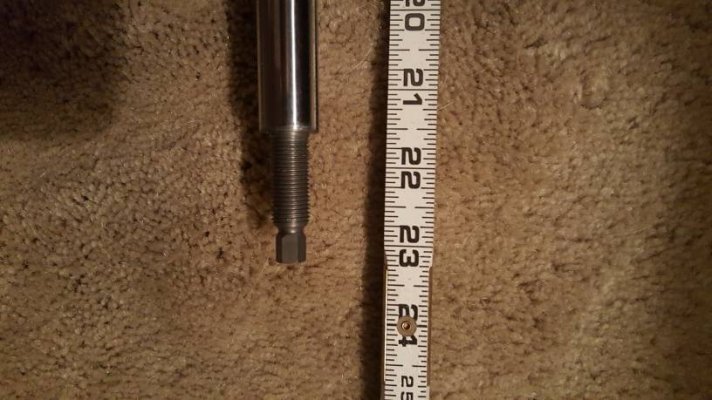

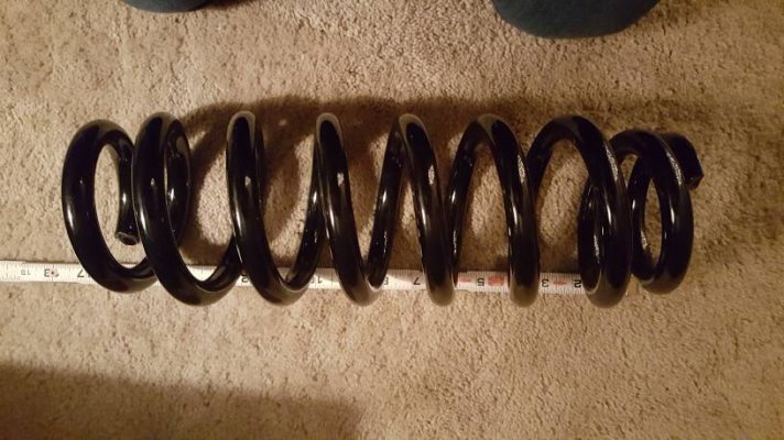

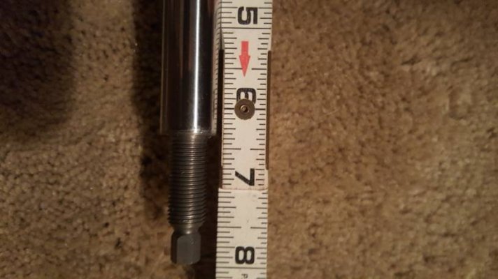

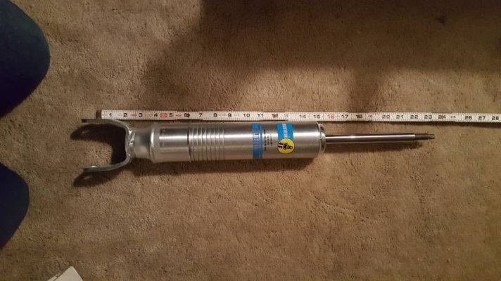

No worries tho I'll be sure to check the measurements right after install and once I get some miles on it. Interested to see how much height I net after they settle under the diesel. As for full bump numbers, it's a pain. If I had my own shop I'd just bolt the strut in assembled without the coil, and run the suspension to full compression under the trucks full weight with bump stops in place. Without a shop I can get us "close". I'll put a Jack under the suspension empty, start at the full extended length of the strut assembly, and than I'll compress it the 6" of stroke the shock has, and I'll measure the difference at the hub center. Should give us an example of what our wheel cycles vs shock stroke. I'm curious myself, as this is my first IFS truck I've modified. Unfortunately it'll be next weekend before I can get these numbers most likely. My 2.5 ton floor Jack just doesn't have the nuts to lift my truck off the ground, and I'm not using the stock Jack, so I need to find some help as my Jack budget got spent putting this kit together. The eibach setup was 575$ this kits gonna be about 1200 with all the new parts. I could have done it with cheaper strut hats etc but I like using local shops and business so I end up paying a little more. Oh well. Should make for a nice pavement queen!
