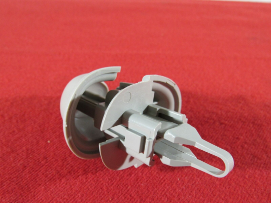

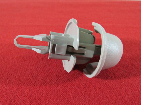

Ok. So I had to break 4 clips to get the headliner out. 2 coat hooks in the back and the 2 in the front for the sun visors. The plastic is too old and fragile to work properly. The fronts are supposed to slide back and the piece should come out easily. All 4 broke trying to get them out. 20 year old plastic is just not as robust as it once was. Ordered replacement parts. Anyone in the future looking to do this make sure these parts are still available before you try removing them. Thank you to everyone for your help on this.
