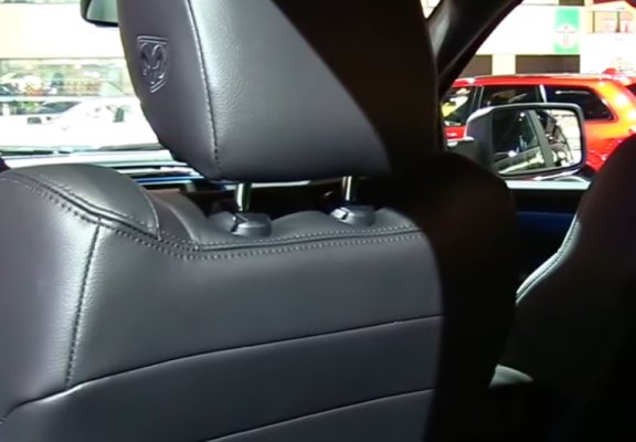

Look close at this picture,i just flipped the drivers side head rest around on my regular cab,didn't cost a dime,lol.Pass side one still faces forward

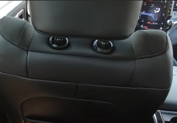

The rear headrests off of a 2011-2018 Ram 1500/2500/3500/etc. or 2019-current Ram 1500 Classic will fit on the front seats, also since the 2019-current Ram 2500/3500/etc. use the same seats as the 4th gen Ram Pickups (2009-2018) the headrests will fit in there too.
The new HD Ram Pickups have it where the headrest is able to adjust by angle, so you can adjust it flat or on an angle like what the original ones were.
2009-2010 Ram 1500 rear headrests MIGHT fit, but they may be too small for your head so I wouldn’t.
Here shows that the length on the poles for the headrests are the exact same, plus I might switch my 4th gen headrest out and put in an adjustable 5th gen 2500 headrest, if I do I sure will do an update on that!
Anyways, here it is.
