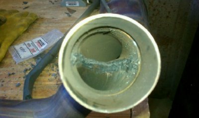

Step 6: Once you have the exhaust in your hands it is easy to see the restriction and what you will need to remove. Look into the end where the collar is welded around the two pipes. You can immediately see the design flaw where the pipes are smashed together. Now you will need to assess the exterior of the pipe and where you will want to cut with the plasma torch. Once you have made the cut with the plasma torch use the oxy acetylene torch to finish the cuts where the plasma would not fit. Be careful not to hack the pipe up to bad. You can use the gas torch to get into the open end of the pipe to finish torching out the restriction.

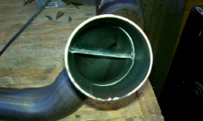

Step 7: With the restriction removed you can begin to use the torch and a pry bar to form the steel around to where it will be tighter to weld. You can actually use the torch to heat the steel to open up the pipe where it is bent before the y. Heat it and use the pry bar to form the steel. Be careful not to melt the pipe.
Step 8: Now weld the joints solid and reinstall the exhaust.
I immediately noticed the that the exhaust was throatier and the throttle response was more responsive. I am not one to waste my gas or rubber, but before my truck would not spin the tires form a dead stop it might chirp them a little. Now it will spin the tires when you floor it. I had no idea that the OEM exhaust was so restrictive until I modified mine, WOW. Now all there is to do is finish it off with a Magna Flow cat back system.
I did not take that many pics as I was doing this. You can see the before and after from the end of the pipe. You can really see how much it opened it up.
