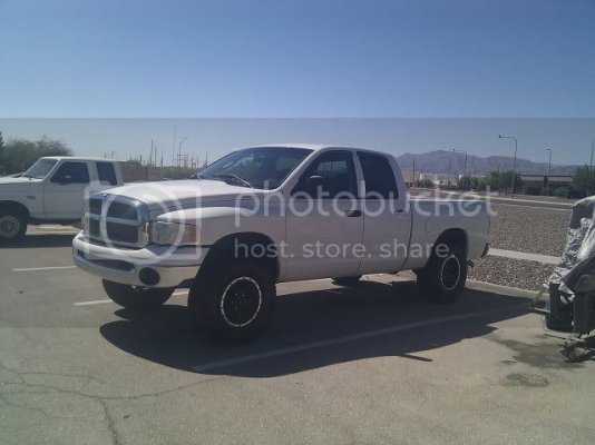

Just for the fun of it heres how it sits right now

looks good man, would leave it as is but would be cool to have a fast truck, anyways what wheels are you wanting to run? a 285/75 is pretty big on a lowered truck but it may still fit, my trucks similar to urs im running the 7'' cst lift right now

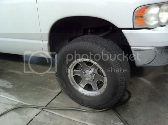

Removed the Plasti-Dip from the wheels

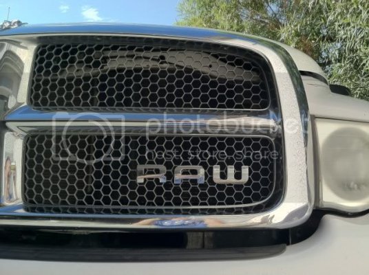

M flip on the grill haha

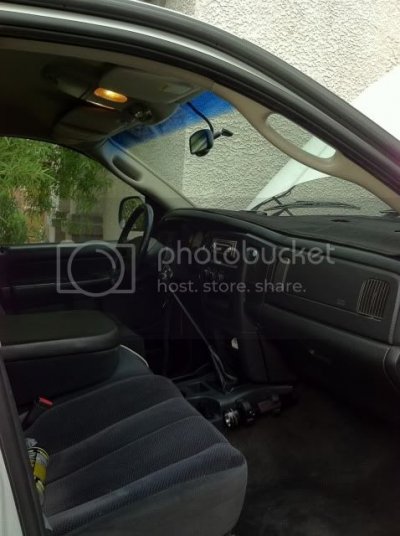

cleaned a lil on the inside, still has ways to go
