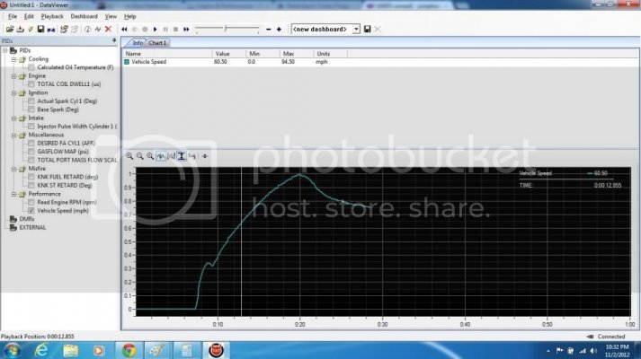

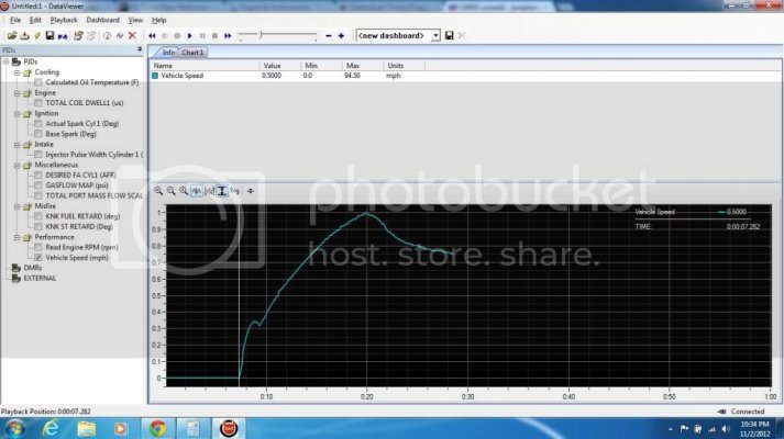

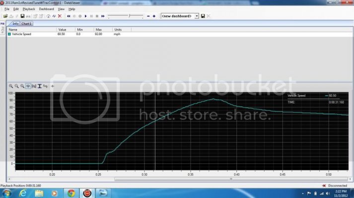

Update....
I just cut a 0-60 in 5.7 secs with his revised tuned he just sent me with 22's....pretty impressive for a CrewCab. Today I'm gonna be swapping out my mopar cai with a vararam intake and swapping my fastman tb (84mm) with ones of Matts (moe's performance) 87mm throttle body.....will report back the results.
Here are some screen shots from my datalogging.....I started at 25.459 secs and ended at 31.16 secs= 0-60mph in 5.701 secs, Sean from Hemifever is getting this thing moving. Just FYI diablo's baseline ran 6.2 secs and Hemifever's first baseline tune ran a 6.0 flat....now 5.7secs on his first revised tuned, he know's what he's doing for sure.
