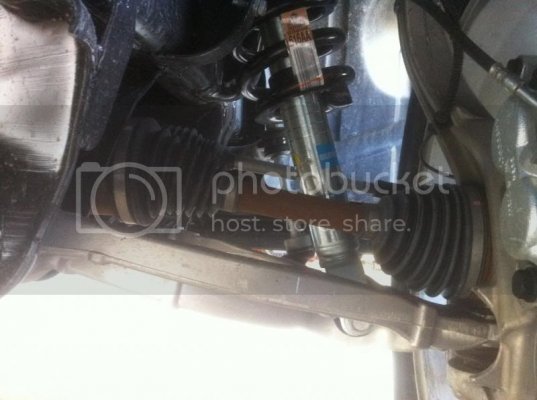

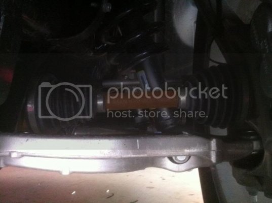

getting ready to pull the trigger on a pair of these and just wanted to see if anyone who runs these have had any problems. Just don't want to put them on and have issues with the cv's or any other front suspension components. just want them set to 1.4 inches to bring it up slightly. anyone have pics of there cv angles with them? thanks in advance

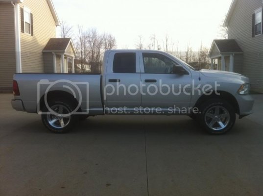

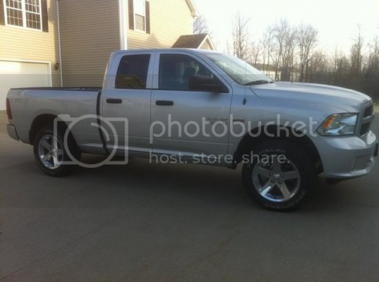

Only on for 10 miles but 2.8" max and no issues on test drive. Drives great too even though no alignment yet. Going tomorrow after I redo the whole thing. Pretty sure I messed up the install. Directions say washer, then stock stuff (dust boot, strut mount), then new hex nut. I did dust boot, strut mount, washer, hex nut. If not corrected I believe the piston shaft will work its way up through the dust boot and strut mount and then ill be driving on all spring and no shock. So as for issues read the directions and not go on what you've done in the past with other cars (normally a damn washer under a nut!).
Front before 37", after 39.875". Rear 39.75". Perfectly level but might add a 0.75" rear spacer for a little rake and more lift.
Stock

Synolimit..... truck looks great man
