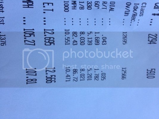

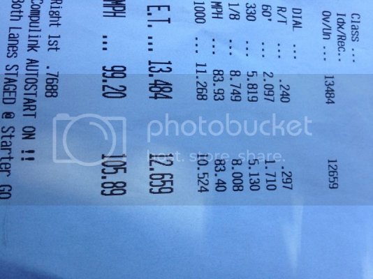

This weekend, 2 of our customers made it back to the track, and put up some very strong numbers...

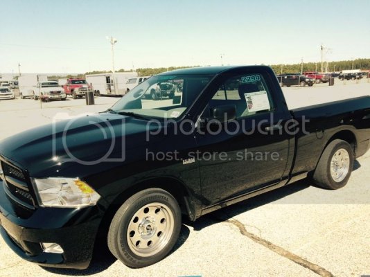

Wes - 2012 Ram 1500 RC/SB - 12.65 @ 105.89 MPH
Hemifever Custom Tune
Short Ram Intake - No Filter
Moe's 87MM Throttle Body
JBA Longtube Headers w/o Cats
Magnaflow 3" Cutout
ATI 15% Underdrive Pulley
V6 Fan
180 Stat
4.56 Gears
Circle D 3000 Stall Tq Converter
M&H 325/45/17 Drag Radials

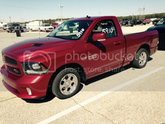

Henry - 2014 Ram 1500 R/T - 12.56 @ 107.81MPH
ARH Longtube Headers w/o Cats
Magnaflow 3" Cutout
V6 Fan
180 Stat
3.92 Gears
MT 295/45/17 Drag Radials

These 8 speeds put up crazy MPH. Wes has a faster 8th mile truck because of his tq converter and 60' time, but Henry runs him down on the big end every time in the 8sp.
For a 8spd 3.92 with small tire thats insane mph. Especially for the weather.
