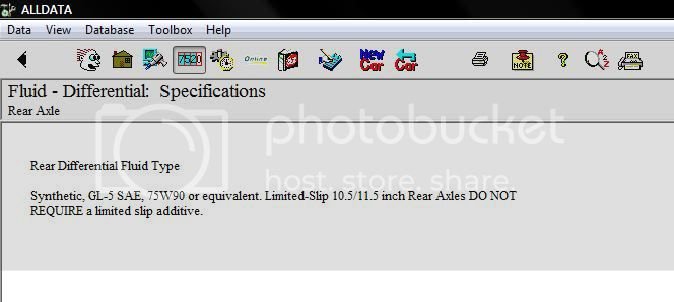

so 4L of 75W90. and just the oil you buy, no additives or anything.

2 qts and the additive.
2500 10.5" = 75w90
1500 9.25" = 75w 140
thank you very much John!
Hey bud, if You have the LSD make sure to get the additive.
Oh an I bet you wont use but 2.5 quarts or so, just fill it just below the hole and return the unopened bottles.
