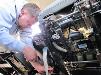

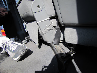

Because of other projects going on within the truck at the same time we removed the seats from the truck.
Front of each seat is 2 bolts:
Rear of each seat is 2 bolts to the floor:
Center console is bolted to both Drivers and Passengers seat:

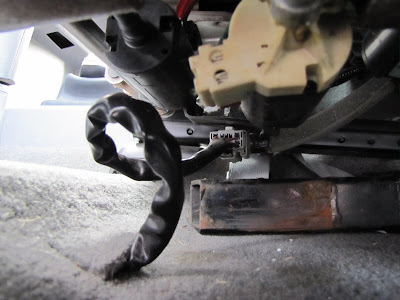

Drivers Seat (and Passengers if equipped with power seats) motor connector:
Center Console power supply piggy-backs from drivers seat:

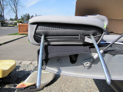

Headrest-
Simply slides over existing cover and closes across bottom:

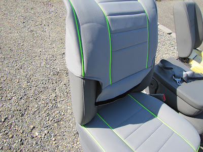

Seat bottom-
Remove back angle lever and power seat cover with screw driver:
Cover slides over and secures at rear with two vertical velcor pieces:
Two buckles secure bottom:
My seats have the skirt piece along the bottom edge. There is a pocket on each cover to slip this flap into:

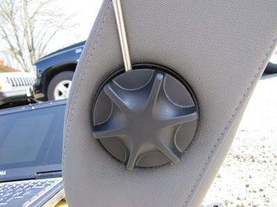

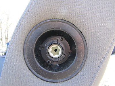

If equipped remove Lumbar Support knob by GENTLY prying off handle:
Remove two screws to remove cover plate:

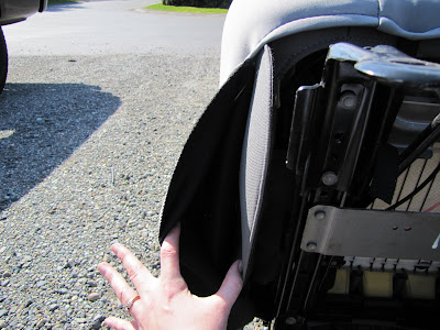

The back piece is a single pieced sleeve that slides over:
The cover is tucked under the head rest supports:
Velcro at bottom of seat back secures entire piece.

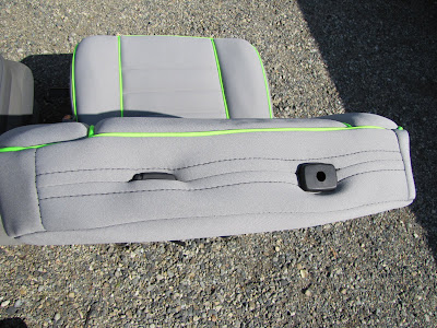

Top Lid / Arm Rest:
A single piece with a elastic strap is slipped over the top of the console. The front button is slightly covered by this. Because of the piano hinge on the back the back side of the cover is just tucked and not very security attached:
Bottom of cargo area / Seat Back:
Elastic strap stitched into cover slide over the front. 4 velcro straps along the back secure across the piano hinge and side supports:
Seat Bottom:
The seat bottom cover slips over the seat bottom. There is a whole cut for the latch assembly; but my latch was larger. I removed the two screws and re-attached over the cover to insure proper closing. The flap across the back is slipped through the back and attached to the sides with two velcro staps on each side:
