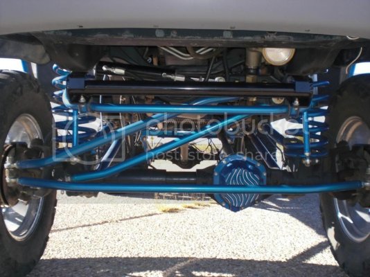

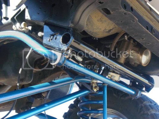

I too have heard good things about the Thuren products.
Here is the DT installed

I ran the DT trac bar on my '00. I loved the unit. Made a night and day difference. Double johnny joints transmit a whole lot of jarring, which destroys the joints too.
I like that the DT has a bushing at one end, and a johnny at the other. Perfect combination of flex and durability.
