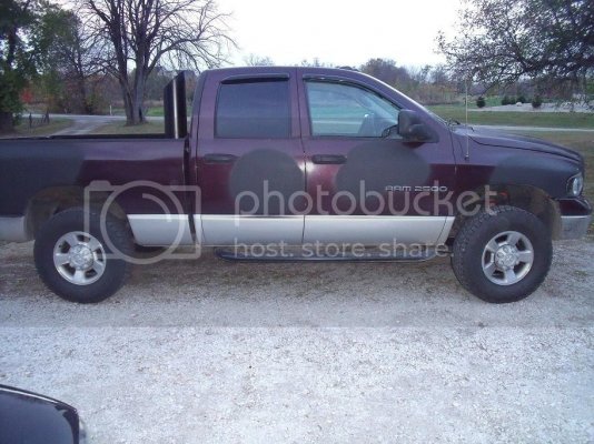

Before

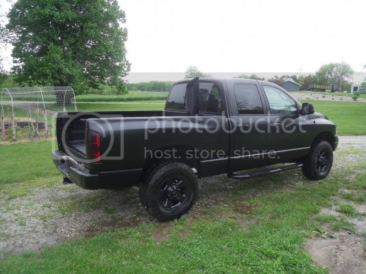

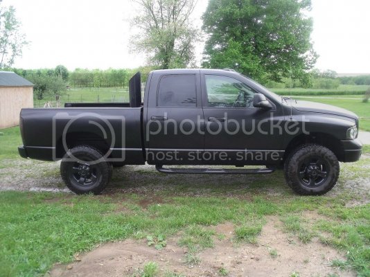

After
With your truck being smaller you could probably do it all with one gallon of paint
You will need 1 pint of hardener an 1 pint of thinner for every gallon of paint(8 parts paint:1 part thinner:1 part hardener)
If your spraying outside an it's hot you'll want to add a little extra thinner to make it spray easier. Extra hardener will make the paint glossier and well harder lol
You'll need a good prep solvent/surface cleaner too, don't skimp on it
Good luck man!

Truck looks Awesome !!!!!!!!! Im really Liking the John Deere Black its Amazing and Thanks for the info!! My next question was gonna be how to cut it with thinner and Hardener... After i sell my Guitar i will Definitely Be buying Paint and Suplize!!!!!!!!
