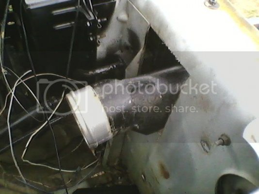

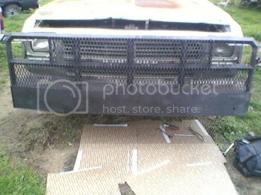

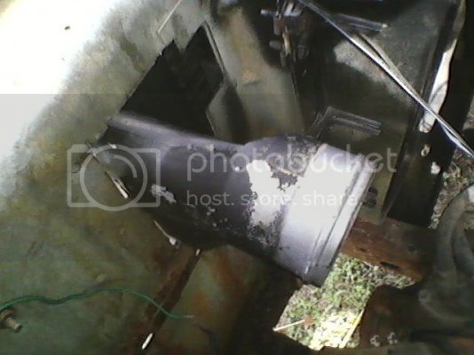

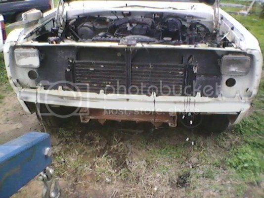

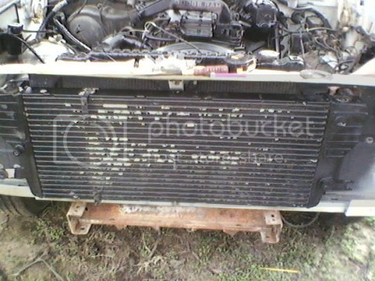

well i just got done putting a 2nd gen intercooler in my 91 d250. it took me about 2 hours to do it. i was really easy to do. all you need is 2 flat head screw drivers,1/2 socket or wrench, grinder, tape measure and a sharpie. i took some pics as i did it there not the best pics but you will get the idea.
first thing i had to do was pull this big bumper off that weighs a ton.

then it was time to put it in. i still got to figure out how to bolt it up but its in.
this is the driver side hole not the best cut in the world.
and the passenger side hole.

If you still have it apart, drill out the corners on those sheet metal cuts.
A sharp corner like you have will lead to a tear in the sheet metal. Fairly easy to do (though easier if done BEFORE cutting).

thanks i did not know that i will go back and fix it. well my twin set up came in today. the turbos are in ok shape not like he said(great shape) but they are going to be nice to have. i will post pics as i go putting it together.

so i should just round the corners off right.
