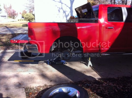

First chalk front wheels. jack up the rear of the vehicle, i used the pumpkin just cause id have to use the floor jack to lower the rear axle later. I used two jackstands to support the frame and i had them on the max height to make sure i had enough clearance to drop the axle. Note: before tires are completely off the ground go ahead and loosen all your lug nuts. now remove wheels. should look like this.

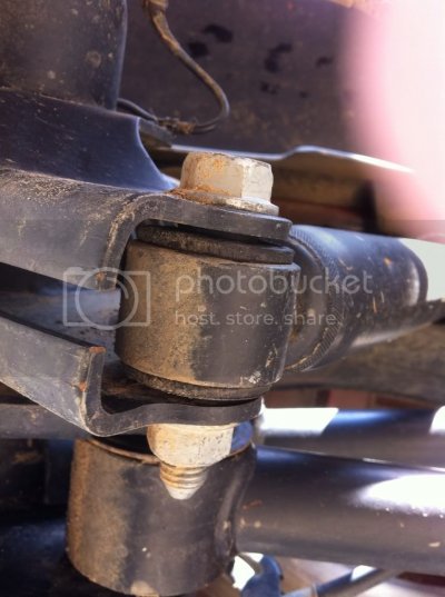

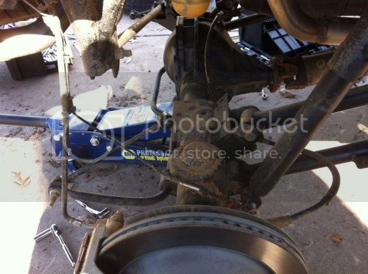

Now with jackstands supporting most of the rear weight lower the rear axle slightly 2-3". Now its time to remove the lower shock mounting bolts. seen here. One on each side, i think size was a 21mm.
Once removed make sure the lower part of the shock is free from the axle.

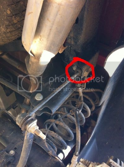

now its time to take apart the sway bar end links. 18 mm i believe. in the picture its the one towards the top, closer to the bed.
One of those on each side and make sure the end links are free and clear of all hang ups. Now you can slowly lower the rear axle. lower it until it stops and than jack the jack up to just support it (just in case). Now remove the coil springs. dont worry they wont bite, they might be stuck in there with some rust just yank them out. this is what it should look like now.

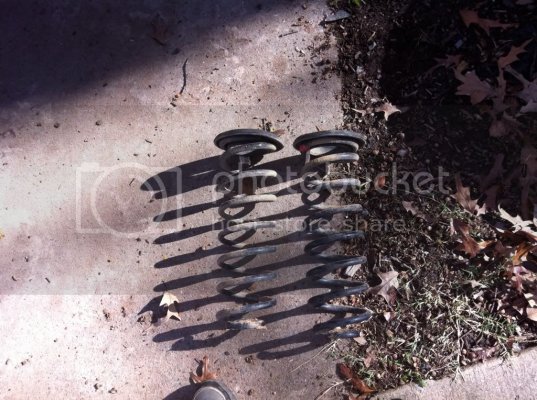

and the coil springs with the stock spacers in them.
Now in stall the spacers on the TOP side of the springs, they wont fit on the bottom side so you should be good. My TGC fit inside the stock rubber spacers so i left them in place to prevent squeeks. Seen here

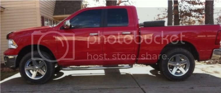

Before :
After:

Well I just read this... after doing it lol and left the tires and rims on, took me 1hour including tool clean up and before and after picture takink. My jack is massive, I had no issue just using the jack to raise the frame up, did it one side at a time.. jack the crap out of it, spring practically fell out.. put my 1.5" spacer on top, seated it, used some good fashion elbow grease and Reefed up on it to get it fully in, lowered my jack, connected back up and done. [emoji736]
This is Bilstein 5100's set to max (stock rear end)... and then with a 3" BL..
And this is just now after I added the 1.5" spacer!
