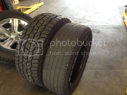

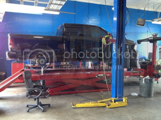

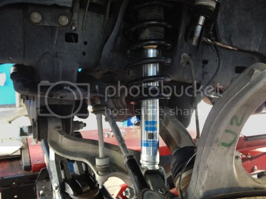

My Bil install and new tires.
Infidel4life11
Nov 11, 2015
17
14
Be Fo
Those new shoes doe
Gettin' it did
All up in it
Difference
Aftermath
Pardon my language I just bought a house in a new upper middle class neighborhood that is right in the middle of the ghetto and I'm trying to get my street cred up!
2014 Sport QC 4x4
Bilsteins 5100's set at 2.8
Cooper Discoverer A/T 35x12.50R20
Before: Front 36" back 40"
After: Front 40" back 41"

Do the tires rub the UCA, swaybar or anything in front or are you running wheel spacers?

About 1/2" of clearance on the UCA's
No rubbing anywhere. I was at the gas station full lock in reverse and ran over one of those tank covers that sticks up about 3". Hit it pretty hard and I got a slight rub on the fender liner.
No wheel spacers
Tires at 39psi

So no work to the rear at all? Just the Bils at 2.8, right? And the 35's don't rub at all? Truck looks great, too, BTW!

No work to the rear at all. Though I will be replacing the rear shocks with Bils 5100 so that I have the same dampening all around.
No rub, no spacers, no cutting, no hammer, no mods at all.
Just Bils 5100 in front set at 2.8!

I can tell there is a handling difference for the better. The steering it tighter, suspension is stiffer.
There is some power loss on the low end. Doesn't bother me any as I am going to tune it.
And I am very happy my truck came with the AMP steps because it feels 6" taller
