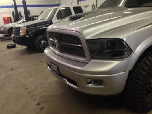

I got 'em welded on today
was eyeing down the nifty dirtymax in the back with the escalade front end. :emotions33:
I'll get the boards back on tomorrow......or early next week. Will be nice to know that they aren't going to rip out of these thick plates now!

god those wheels are dirty...you are slacking....lol

I might clean 'em next week.
