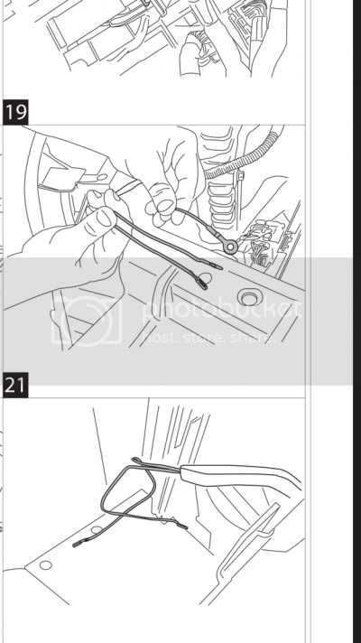

Silverhawx
Feb 12, 2017
Colorado
6.7
Think this might be more economical.
file:///storage/emulated/0/Download/5_fog_light_wiring.jpg
