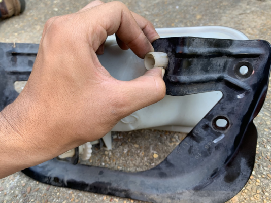

Might anyone know where to purchase the fog light clips?
There are 3 of these on each bracket in which the fog light snaps into to attach them to the mounting bracket.
I was looking for options before heading to the dealer.

So, after exhausting my efforts, Mopar only sell sells the clips and adjuster with the fog light. Not separately and not with the mounting bracket.
Looks like I will purchase new OEM replacement fog lights to use the clips on my upgraded fog lights.

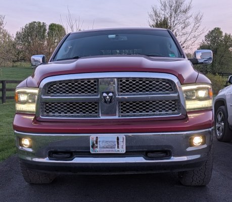

I ended up ordering some fog lights from CarParts.com that had the clips on them and transferred them to the new Morimoto XB LED fog lights.
