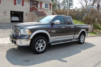

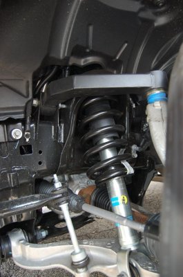

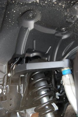

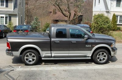

Bilsteins at 2.1" and Zone Offroad upper control arms done.
After a nice 100 mile jaunt yesterday I remeasured the wheel well heights on level pavement and am very pleased : Front = 38 1/2" and Rear=39 1/4"
The ride is indistinguishable from stock and feels solid and secure
I will defer tire selection until I am certain the ball joints will be OK but looking at the build quality of the Zone Offroad control arms I think we are home free.
Thanks to all on this forum for all your help!
Dante:favorites37:
PS my photos : Finally figured how to post them!!!

Looks good. I really like those upper control arms. What are those costing?

Did you do just the Zone UCA and Bils? Or did you do Zone 2" Adventure Series lift UCA?
