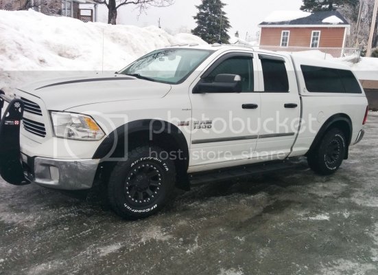

danmp
Jan 1, 2014
515
116
Québec city, Canada
I honestly don't like truck with wide tire on a truck that don't have a 4"+ lift.
I put 17" with stock size ko2 with -6 mm and oem flare on my truck and it's just fine for me.
I didn't see the point the put 300$ more on the ko2 just to get 285" and lost in mpg and more stress on the suspension.
I think it's everyone choice, some don't like the look of the 265 and some don't like bigger tire , at least for me me I don't find them 300$ more beautiful.
Stock tire size with 17x9 -6mm offset
