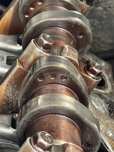

Also did no change. Lifters and rockers are new and all look fine. I noticed some of the cam lobes the first cam lobe and 2 last cam lobe almost look out of shape and worn
Almost if if the point of the lobe is worn more oval? And this lobe seems to be near where the noise is coming from?????
Ah haaa! You might be on to something. Are you going to mic it out (measure?) to verify?

Before digging into this even more
Just by visualizing in the picture
Does it seem to be more oval then the other lobes?

It 'does' appear more rounded..by my eye. But that's eye only. Do you have a digital vernier calipers you can rough-measure it with? Maybe go get one from H/F. Make sure you're measuring like lobes (e.g. exhaust vs exh).
What does the oil pressure look like? Did you ever put a 'good' gauge on it? For example, at idle, hot in gear...foot on the brake, how low will it go? And what's the pressure at a steady 1200-1500 rpm? When you run it with the valve cover off, do any lobes seem to be starved for oil? Particularly that one? How do the rollers on the rockers look and 'feel'? Do any feel particularly loose (if you pry down or compress the valve spring HERE)? Could any of the rockers be slightly bent/worn? Basically it's probably going to come down to the cam lobe, rockers or a weak/plugged/bad lifter.
