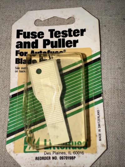

what i did was to buy 1 fuse kit that has a Tester in it
I like the BUSSMAN & Littlefuse fuse testers
View attachment 549425View attachment 549426
This tool is a game changer - I used to have no issues with the bigger fuses, but now with the micro and even smaller fuses, I can't get ahold of them without needle nose pliers. This tool doesn't damage the fuses as easily.
