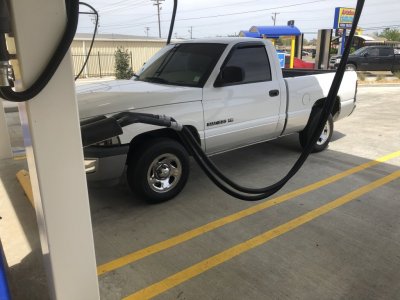

i just got a new lift coming in for my 2001 Ram 1500 2WD V6 3.9L and I was wondering if I would be able to fit 33x12.50x20 tires with 20x12 Hostile Alphas with -44 offset? Also was wondering if I could get your guys and gals opinions on my 4th gen to 2nd gen bumper swap I’m dumbfounded by what color I should paint the bumper since I have a silver bottom trim here’s a pic of the truck stock

Coil spacers in the front and blocks in the back with MaxTrac Suspension all the way around

Leaf spring stock adding the blocks but my mechanic I use tried installing the lift in the front today and the spacers wouldn’t let my springs compress enough to get them to connect my spindle back together so I had to order 3” spindles today from Doetsch hope this works

On A-arm style front suspensions - raised or dropped spindles are always preferred to coil blocks or longer springs - the spindles don't change the operating angles of the ball joints, control arms, etc.
