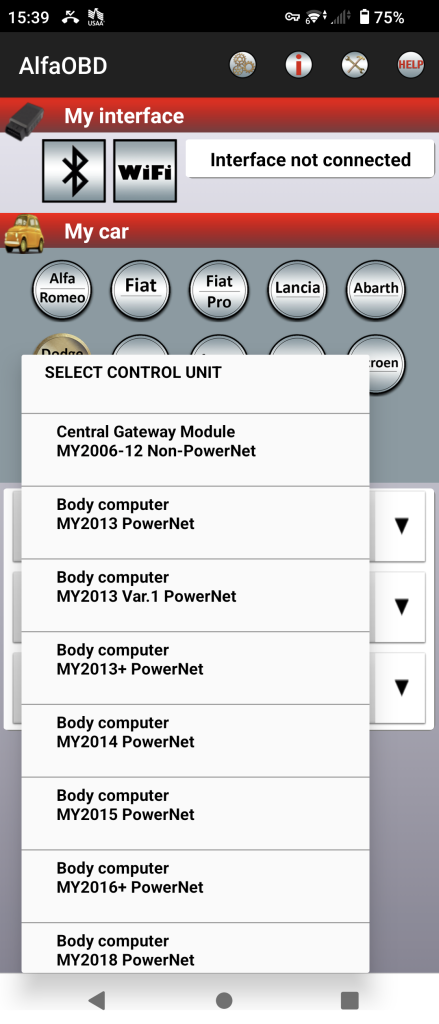

Activating: To activate, you'll need an OBDLink MX+ or similar, and AlphaOBD. Using AlphaOBD navigate as follows (presuming you have successfully enabled and connected to your OBDLink MX+ at some point):
1) Put your truck's ignition into "Run" but do not start your truck
2) Open AlphaOBD
3) Connect using your preferred method (bluetooth is what I use)

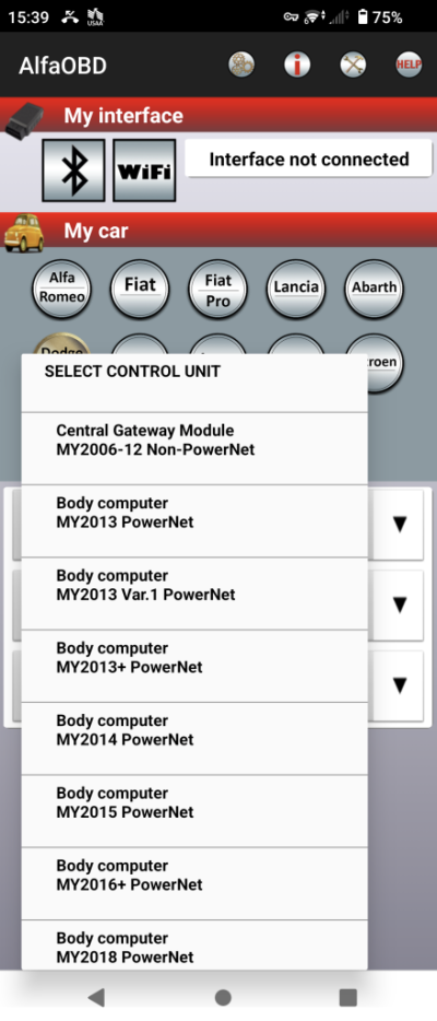

4) Select the correct Body Computer Control Unit - for my 2017 RAM, it's the "Body Computer MY2016+ PowerNet".

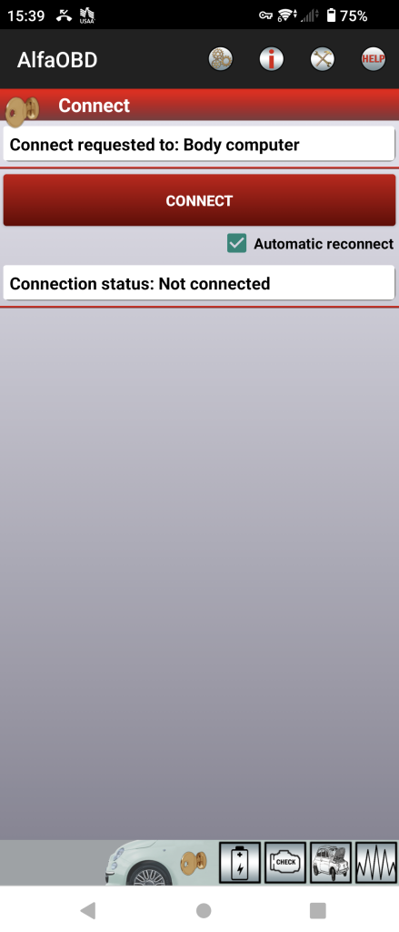

5) Connect:

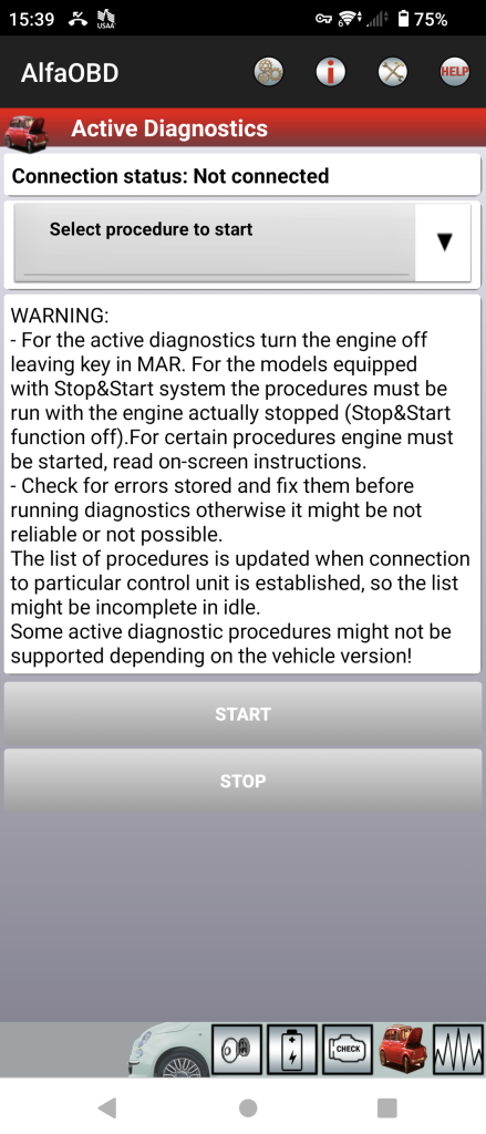

6) Select the Icon with the car hood that is up:

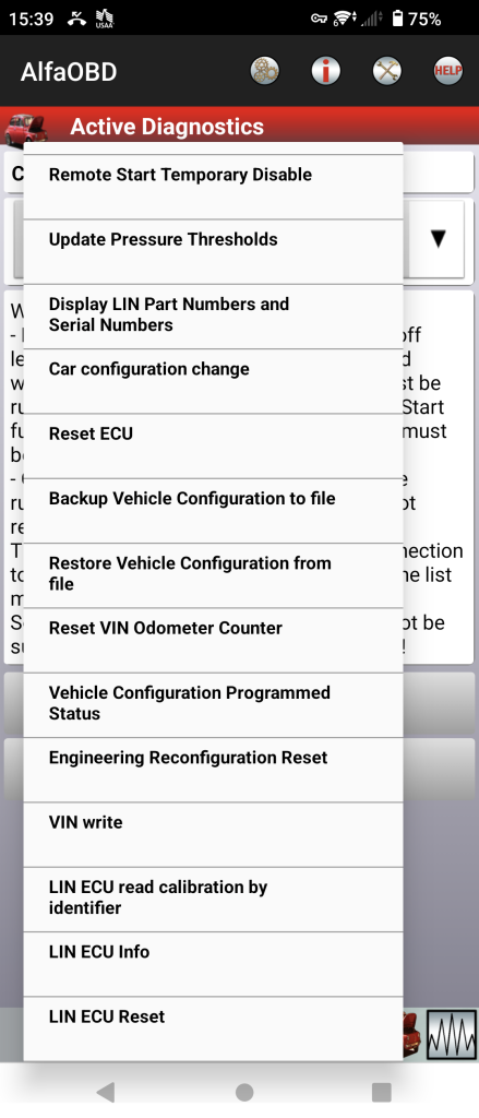

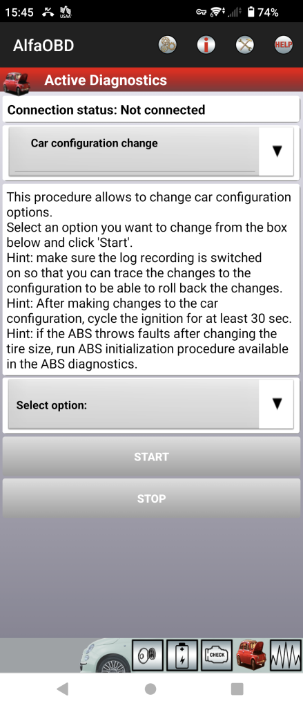

7) Click the Dropdown arrow next to "Procedure" and scroll down to and select "Car configuration change":

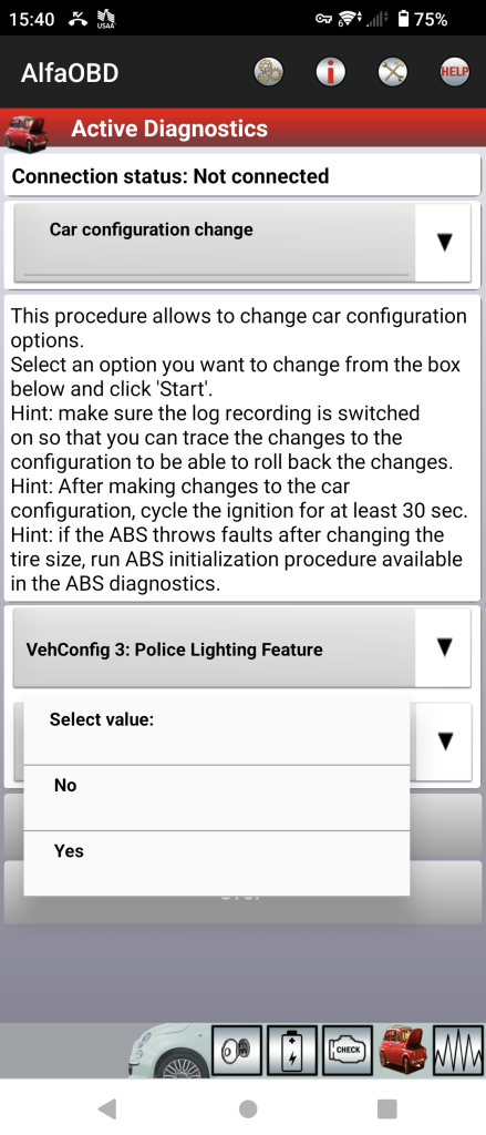

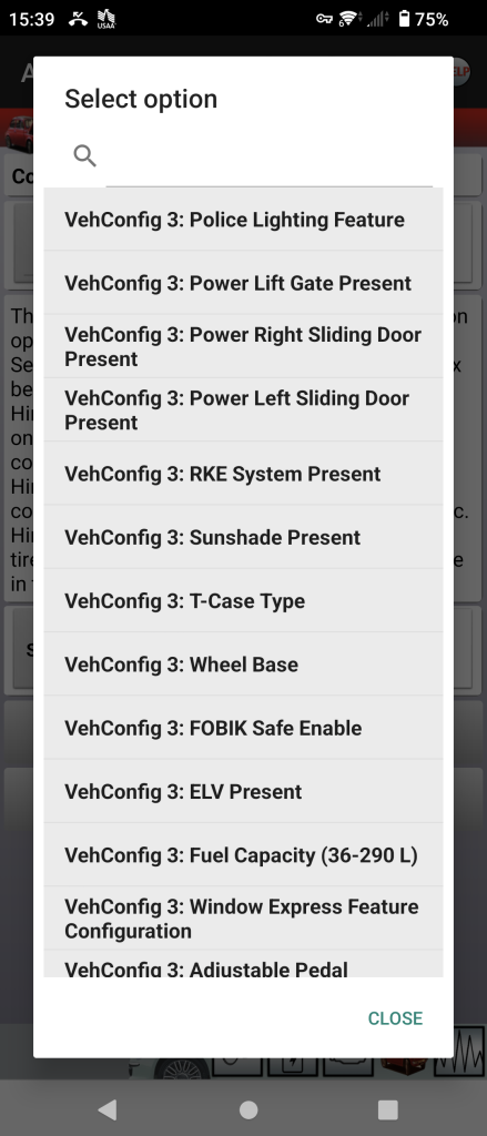

8) Click the dropdown next to "Select Option" and scroll down to and select "VehConfig3: Police Lighting Feature":
9) Click the dropdown next to "Value" and select "Yes", then click "Start". Once the BCM is scanned the current value will be displayed in the text section, and the "Start" button will change to say "Next". Click it. Now wait for a few seconds. Once the procedure is complete, you will see "Procedure Complete".
Congratulations - you've now got "police" lighting modes inside your vehicle.
