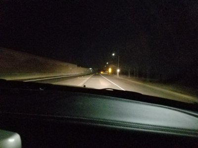

I've been asked a few times to post pics of the light output after converting to Philips 65w 9011 HIR1 bulbs in the factory projectors. The light output works well for me and doing all four for $36 total was a steal. I converted both the high/lows as they both use 9005 bulbs. Best part IMO is I didn't have to mess with drilling caps, running wires or worrying about ballasts burning out. I have the Philips 55w HIR2 9012 bulbs for the fogs but realized i hadn't done them yet, totally forgot as I got busy. Hope this answers the questions some had.

low beams only
low beams w/ 9006 fogs
on the road perspective
High beams only
