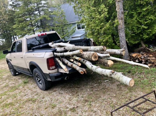

Does air ride preventing 1500 squatting when fully loaded? My 2012 Ram 1500 was too soft, squatted down to the jounce bumpers. The solution was not to add more springs, I don't think, because I questioned whether their frame was robust enough.
So I got a 2500, which had switched to 5 link coil rear suspension. No squatting, better ride than leaf spring 2500. But more expensive too, just like adding air bags to a 1500.

Bit loaded that day, all fresh cut trees, don’t know the weight, but it was heavy. Not squatting

@MSandRebel already answered your question, but to confirm, when I towed a boat with the 2017 Rebel I used to own the air suspension prevented the truck from squatting at all. Not sure how it would do if the load is near the payload limit, but I suspect it would do just fine.
