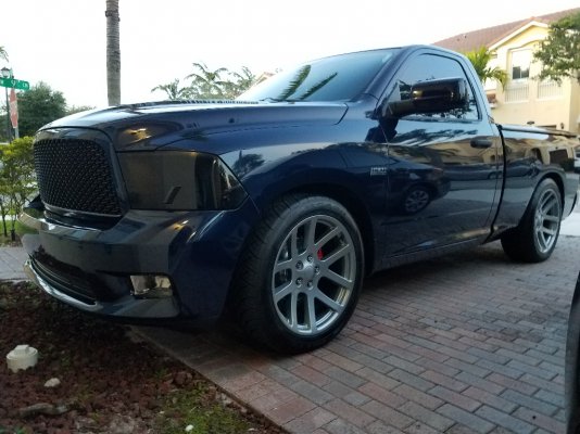

Pics of the truck I have plenty...unfortunately, none under the truck with the suspension issue at hand...

I dont have the answers for bumpstops, just wanted to see how the truck looks/sits...;)

I see your rear tire is not centered to the op
