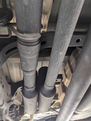

The guy that did my exhaust used a different size pipe he added on when he did the work so not really sure how big of a deal that is.

Looks like he used the factory 3” to save some work

Yeah that's what he did I can't tell if it's 2 or 2 1/2 in the other side it's considerably smaller though
