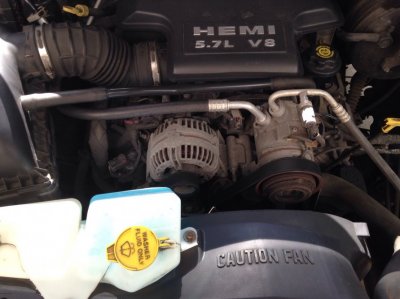

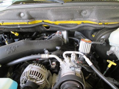

I don't know about the E-Bay CAI's, I run a K&N Performance II CAI with a AirRam cold air duct.

What's the filter looking thing behind the ac.
That is my crankcase air filter which prevents hot oily air from being drawn into my cold air duct. This helps keep the TB from getting so oily.

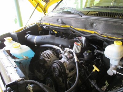

The K&N CAI cost me $219.99 thru Amazon.com and the breather washable filter was $28.97 also from Amazon.com. The instructions are very good, but as I read in other posts/forums, the hardware isn't the best. Unless your TB is dirty, cleaning it is not a requirement to install the K&N CAI. I also installed a AirRam air scoop to help direct air into the inner fender, this helps flow air into the CAI air filter. I got it from airram.com for $39.00. You can see the scoop installed on my truck in the attached photo.

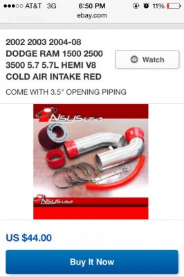

This is something like I'm talking about
