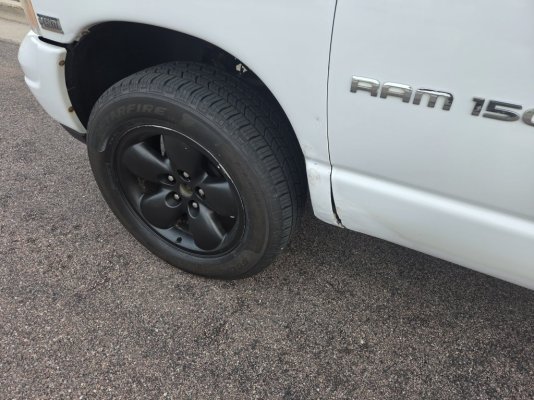

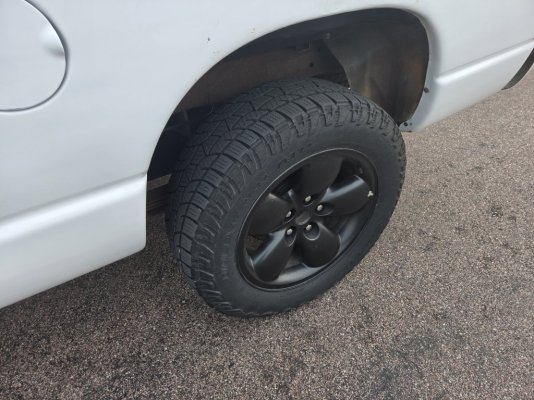

I have 2 different sets of tires on my winter rig for the summer. Ive been told both ways about different sizes and types of tires on a 4x4 but have gotten conflicting information on it.
All 4 are 275 60 20. The front 2 are the same brand and model and the rear 2 are the same brand and model. Both sets have roughly the same tread depth.
Is this an issue? I would think its fine to drive like this and Ive put on several hundred miles already so I hope so. I had these tires sitting around and dont want to burn up my bfg ko2s on the hot pavement this summer if I dont have to. The current tires are ... front 2 are starfire ht's and the rear are cooper discoverer atp's

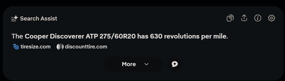

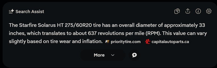

Instead of using our magic 8-ball, how about we examine the physical properties a bit closer and then make a judgment call? This is a good learning moment for somebody.
Plus, this is assisting me with procrastination, which is important. :cool:
As a rule, I tend to avoid using AI for anything technical, but after an unproductive traditional type search for the Starfire HT specs, screw it. AI rocks today.
These specs are based on new. It would be impossible to account for size changes due to wear.
The rear - Cooper Discoverer ATP 275/60/20 has a revolutions-per-mile rpm spec of 630.

The front - Starfire HT 275/60/20 has a revolutions-per-mile rpm spec of 637.
So the difference we are concerned with is approximately 7 revolutions per mile.
The front tires are turning faster, therefore smaller than the rear tires.
That doesn't sound very significant. Nobody should be driving on dry pavement with 4WD, so who cares about 1.1% difference in wheel speed?
Most tire manufacturers will list the rpm spec of their tires.
