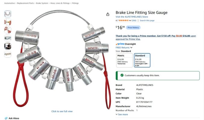

.... i just need to know what the fitting size is off the abs block to that rear bracket and line size really. I know how to do brakes but i don't want to be buying 8 different sizes of stuff and still not make headway. ....
In this situation, I use one of these gauges (pic below). I have both the 'Standard' and 'Metric'. This is a very handy little set of gauges. If you have a mechanic friend, I'm pretty sure they would have these and let you borrow them. Otherwise, as already stated, take the old stuff to parts store and match it up.
Additionally, be sure to use Copper-Nickel brake line, it bends and flares easier, and lasts life of vehicle. And don't forget, brake lines utilize a double flare.... a cheap H/F tool might not be able to do a proper double flare. If you're using a standard steel brake line, then a cheap H/F flaring tool will likely NOT be able to do a proper double flare.

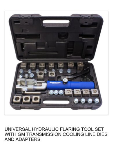

I use the HF tool often makes double flares just fine its often user error lol.
Haha, yes, I agree. I suffered with a cheap H/F flaring tool for a long time, it might work if you were lucky. Then I finally broke down and bought the kit below.... and WOWZA :p ....... now I can make all kinds of perfect flares on all kinds of materials, even with the line still on the vehicle. I've never once regretted spending the money on quality tools.
