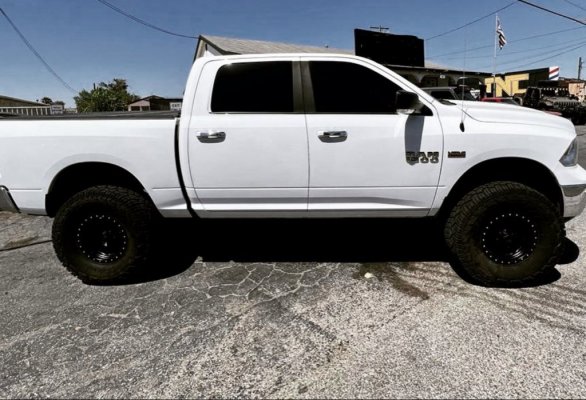

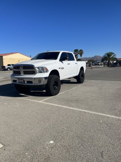

Yea I’m thinking they were there before also. I know one was. He did say my lower control arms were showing some signs. Not failed or anything but possibly think about replacing them. I’m planning on doing that next week and see if I notice any changes. Anything else I should replace while it’s apart?

Ram looks great :waytogo:
Odds are if you feel it in the steering wheel…… it’s from the front end.
If you feel it in the seat….. it’s from the rear.
