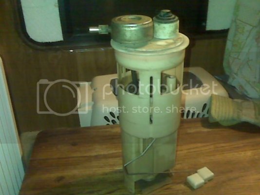

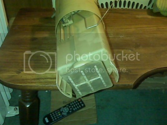

This is what you are going to be replacing.

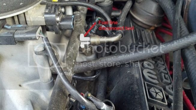

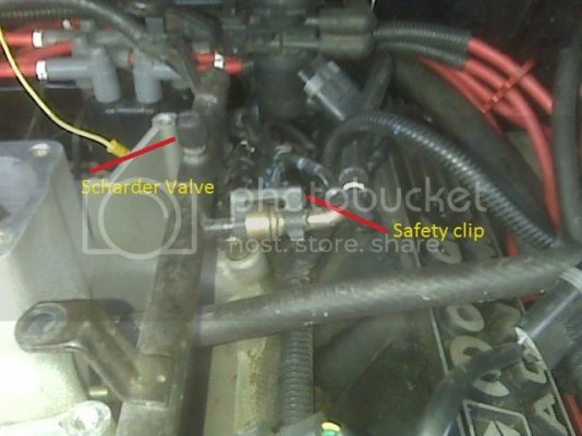

1 On the driver’s side of the intake you will find a Schrader valve for the fuel system, place a rag over it and use a small screw driver to release the pressure. Be careful the fuel may be under pressure. Remove the metal safety clip from the fuel line. Install the fuel line disconnect tool over the metal part of the fuel line, slide the tool into the disconnect fitting and separate the two lines.

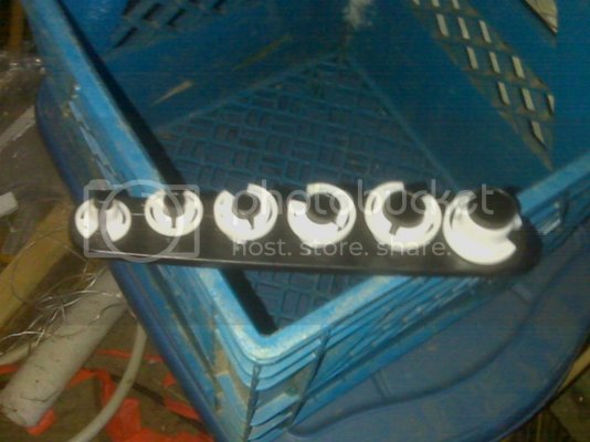

Fuel line disconnect tools.

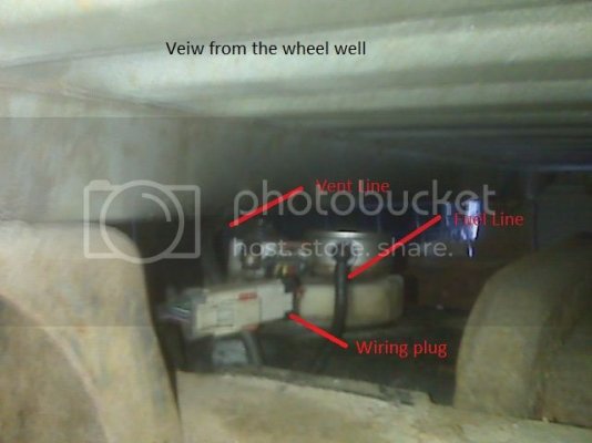

2 Remove the plastic wheel well liner, this will give you access to the pump, and fuel filler neck. It’s a tight area to work in but it is doable.

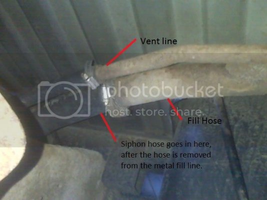

3 Remove the hose clamps on the fuel filler neck (5/16 nut driver), and separate the vent hose & the fill hose from the neck. Leave the hoses on the gas tank side. If you still have the factory hose clamps they can be a pita, I use a pair of tin snips to cut the clamps up by the heads and the use a screwdrivers to pry them off. Once separated I remove the metal fill and vent tubes from the box.
4 Insert a siphon hose into the big fill hose and down into the gas tank and start a siphon of gas into gas cans. You won’t get all the fuel out; about two gallons will remain in the tank. Find some type of clean plugs you can put in the ends of the hoses to help keep dirt out of the tank.
5 Disconnect the fuel line from the pump by squeezing the plastic tabs together; up where the line attaches to the fuel filter/psi regulator. I use a big plastic tub under the fuel tank to catch any fuel when the line is disconnected from the fuel pump. This fuel should not be reused dispose of it in a proper manner.

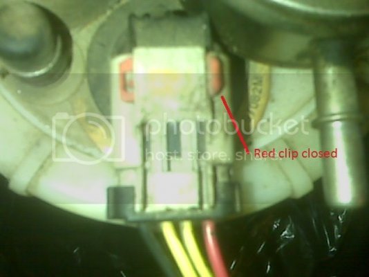

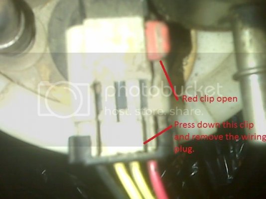

5a For the wiring there is a red tab that needs to be put in the open position; I use a pair of small water pump pliers to move this clip, then you must push the other clip down, the plug can then be separated from the pump.
The rollover /vent valve hose can be removed at this time as well.

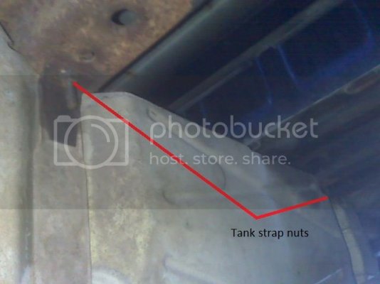

7 Start to remove the gas tank strap nuts up near the frame (15mm deep socket) loosen both at first then remove the back strap and let the tank rest on a milk crate, and then remove the front strap.

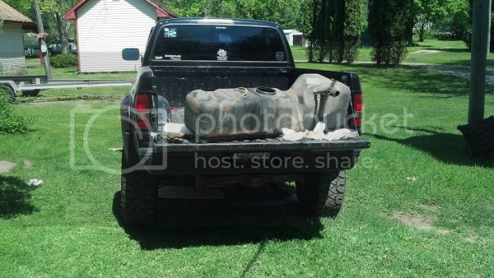

8 Lower the tank to the ground.
