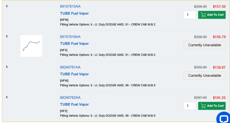

Is part "Fuel Tank - Mopar (68323675AC) - 26 Gallon Tank" a direct replacement? Like i do not need to add anything if nothing else is damage I.E. Pump, brackets Etc. I have having filling issues and we have replaced everything except the tank now. Which is my next step.
Also if i upgraded to part "68323674AC" the 33 gallon tank, what would need to be done? this is out of Curiosity mainly!
2018 Ram 1500 Sport 5.7L V8.
If you were to upgrade to the 33 gallon tank, it seems that almost all of the parts are the same with the exception of one of the fuel vapor tubes. NFW = 26 gallon tank, NFX = 32 gallon tank, 98 = 140.5" WB, 91 = 149.5" WB.
