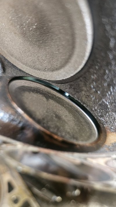

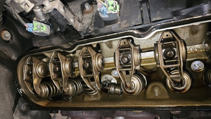

They've had problems for over a decade and a half. Don't ask how I know. Didn't even make it 90k miles. By their standards nowadays, I guess I wore it out. Lol
Lifter failure, bent pushrod, broken spring, followed up by bent valve. It was an awesome Wednesday afternoon.

The photo I posted is one of the lifters that does it. Yeah I could of eliminated it and programmed it out but I didn't have time for all that. I had to get it back up for my wife. Plus I was able to locally source all the parts, including the valve and seal shockingly enough, so it got a lap job by hand with all new passenger side lifters, head bolts, gasket, pushrod, ect. and sent it.
It is a good driver with 420hp so kinda worth it. Lol
