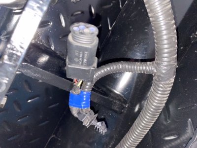

2020 Ram 2500 4x4 - three connections behind the rear bumper I need help identifying.
These wires were tucked up under the bed which had to be removed to repair the bedside and install the aftermarket bumper. All connections are on the driver side rear cluster behind the rear bumper.
Connector #1 - four pins with four wires - red / yellow (white), purple / white, black and yellow

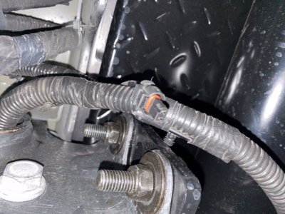

Connector #2 - two pins with two wires - two gray wires - couldn’t identify stripe colors in the dark

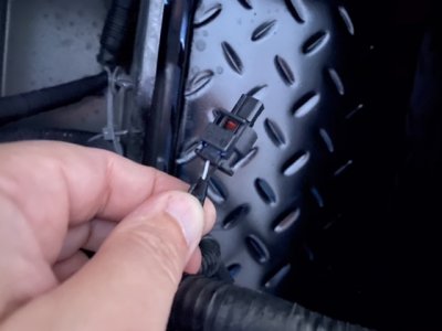

Connector #3 - two pins with two wires - black and white

Assuming backup and blind spot ?

Not certain however the four wire is trailer lights , one set of the two wire is for chmsl for a camper top ,second two wire probably back up camera.

Could one of these be for rear Park Sense parking sensors??

I don't have park sensors on this truck.
VA-RAM
Nov 17, 2019
166
106
STL, MO - Norfolk, VA
2017 Laramie / 2020 Laramie
which would make sense of why there is nothing there. lots of plugs don't get used on a harness just depends on what equipment they have.
Which was my point...most of the time the wiring harnesses are all installed so that they can add whatever options are needed for whatever truck. If there are plugs under there that are used for an option you don't have, its still the same harness that is in other trucks...
