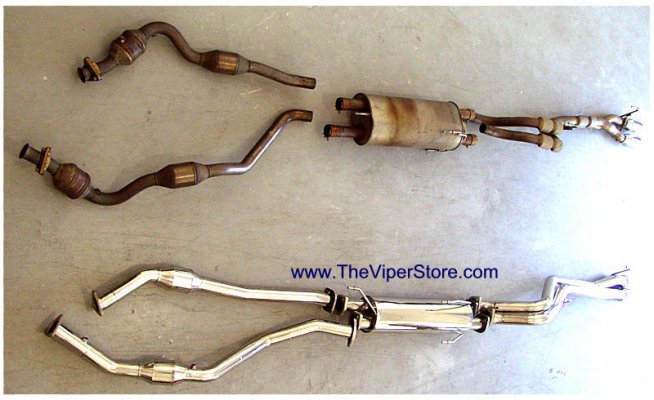

2. Dual exhausts, there’s a plethora of blogs about several types but I haven’t seen
anything with old style real dual exhausts, the hemi’s getting long tube headers
and would love to run right straight out the back through a cherry bomb.

2. True duals CAN be done in these trucks, but not like the old days; there just isn't provision for it under the truck. You have to snake two pipes down the passenger side the way the SRT truck did (though the factory used a single muffler), then you just need to decide on how you want it to exit out the back:
