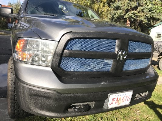

Hey, I meant to update this a while ago but life got in the way.
It hasnt held up at all actually. I learned some stuff along the way that would have helped it hold up way better but it was stuff I could really only pinpoint once they happened.
First thing: bumpers expand and shrink with weather. I live in Fairbanks and when the temps hit -30 the bumper REALLY shrinks, so much so that the "shell" of the bedliner was the size i sprayed but the bumper wasn't. This caused it to almost molt if that makes sense.
I called a local place who specializes in Arctic Grade bedliner and he said I was spot on with bumpers, they are a huge pain to bedline for that exact reason. The only way to attempt to counter the shrink of the bumper is to entirely encapsulate the bumper front and back, but with a very THIN layer.
I laid down a nice thick bedline coating thinking "oh yea, thicker and strong is better!" but the thicker it is, the less flex it will have.
Against rocks and chips when I had it in the Fall it was amazing. They gravel the roads and salt in the winter and I constantly hear pings on the bumper but never had a single chip due to a rock. Once it hit -30 and colder (and probably before, but i never noticed) it started flaking off in palm sized chunks.
My advice: dont do it. Bedliner is too rigid for a DIY bumper project. I am looking into powder coating, but the nearest place is 400 miles away. This looked great, but could not stand the weather test.

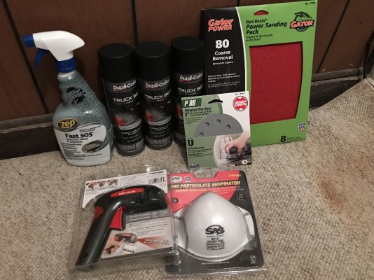

What you will need:
I was pretty quick changing out sanding pads, so buy an extra pack just in case. I used 3 cans for both bumpers but a 4th would be good to have on hand. Respirator or mask is a must, this **** is no bueno if you inhale it. Its pretty noxious stuff! The pistol handle for cans is a cheap and invaluable tool and highly suggest picking one up at your local big box hardware store.

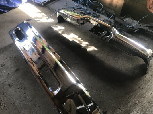

Remove all the stuff so you get to this point here and see a truck that looks like it got curb stomped
Start removing all the brackets and end pieces from the bumpers, the trailer plug is simple snaps that push in and the plug pops out the license plate side. The license plate lights have a metal frame slide (not sure what its called) that you just pull out and the light drops out, it'll make sense once you get there. To remove the plastic step cover, I used a panel puller and a pair of pliers to pinch the tabs underneath and the panel puller to pry it off. This is about what it should look like after:
Wash both bumpers with some good dish soap to remove any dirt (yes, wash twice). Do a quick wipe with a towel, and then spray with the degreaser of your choice. I chose the Industrial degreaser from Lowes and it worked great, again, a mask or respirator along with eye protection is recommended but work at your own risk!

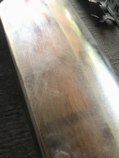

And now the scary part, taking a power sander to that shiny stuff!
First few passes made me nervous as hell but figured i already committed. What I suggest, in order to get the best surface for the liner adhere to, is to get it all sanded with the OS and then get at it with a block and sand paper to make sure there are ZERO shiny chrome left. This is about what it should look like before you use hand power to sand: vzgsFzv.jpg
And after using the hand power

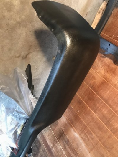

First layer should be relatively thin but make sure you get a good coverage. It's okay to see some metal behind but make sure its uniform. I wasnt as careful on my rear bumper and ended up with some tiger stripping. I was able to smooth it out in the next couple layers but I made more work for myself than necessary ftryNdK.jpg
The liner has a 20 minute interval between coats. I started with the rear bumper, set a timer and started on the front. Once the front had a coat, set a different timer, and I had about 7 minutes to grab a beer. Make sure you set up your bumpers in a way that allows you to hit all the angles, especially the corners. I found those the most difficult to reach but pay special attention otherwise you might get flaking. cZsqpa1.jpg
While curing:
Allow bumpers to cure over night before re-installing.
