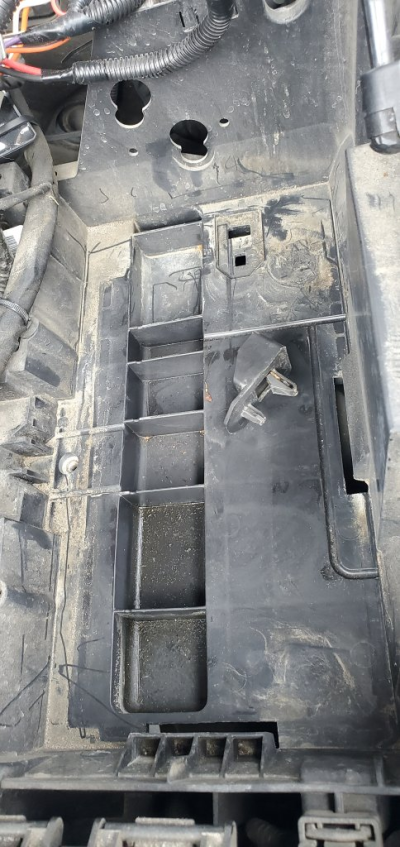

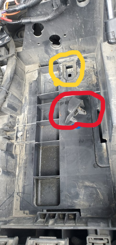

Take out existing battery, look in bottom of tray, you will be able to see the plastic block that holds the H7 to one side of the tray, that is the only piece you have to take out to fit an H8.

This is the piece you are removing, not the hold down bracket. Just use a thin flat bladed screw driver to release the tabs holding it to the tray.
H8s are longer not wider. Left middle of picture/battery tray you can see where the hold down bracket and bolt go.
