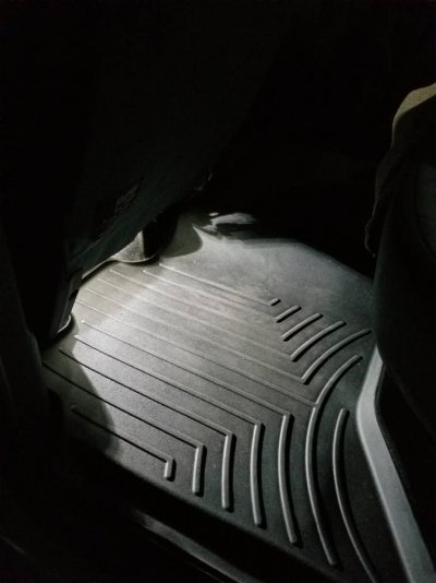

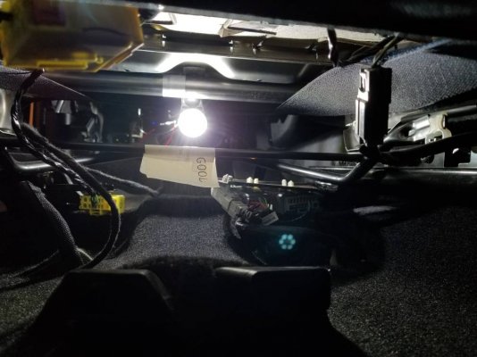

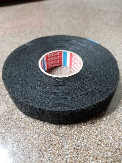

I already had two of these up front in the factory location but Sunday I picked up 8 of the T-10 style housings and pigtails from the junkyard for $20 and added under seat lighting so I could see better in the rear floorboard. Completely satisfied. I wrapped my wiring in tape similar to what they use at the factory and it looks great in my opinion. Not overly happy with how it is mounted but I wanted it as low as I could get it to shine in the rear as much as possible and in the center. 8e5b3e3f4bf6d8c23c7c7a9a08c4e920.jpg990d13811dccce82b41fe965493106ec.jpgb4ad6d03341c9d8c497d700bf5d56fb2.jpg69d521604a767ce673c8c7f1aa00d35a.jpg

Looks really good. I been looking for a way to add floor lights in the back seat. Where did you tap power for the lights?
Austen
Jul 30, 2018
315
149
Missouri
I tapped into the factory floor well lights up front for my power.
