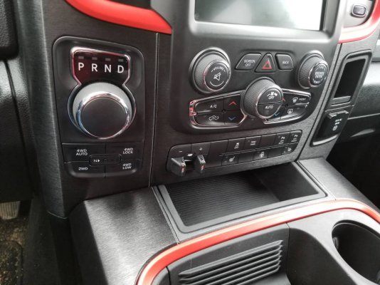

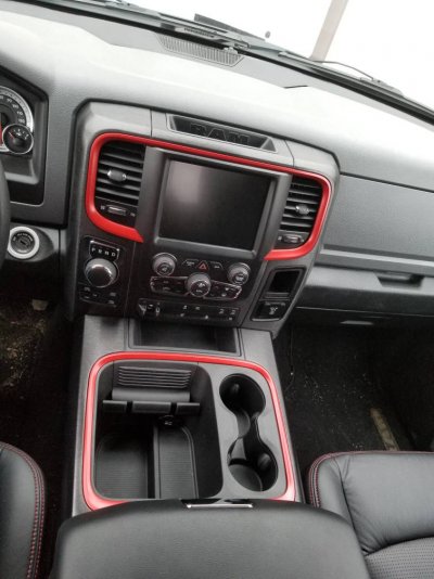

So I decided to make things a little more unique in my '15 CC Big Horn by vinyl wrapping my console. I used 3Ms brushed black vinyl and complimented it with their smoldering red. The smoldering red I think looks like a very close match to the Rebel's red trim as well.
Now all I need to do is figure out how to do the door trim to match.
Anyway, here's some pics! 449f071dcde85feb911a2d47d2d9962b.jpg28ce40a4d65df6f7b889a88d1b81c184.jpg10b4d2abd25b9f48e9c42a6c665b291c.jpga8439705c08760d3ee7b3b575d4acd58.jpg

How in the hell did you do those edges and corners without wrinkles... Ugh

Lots of heat. If you heat the vinyl, then evenly pull it around the corners and edges. I don't have a link to one, but if you Google how to wrap mirrors, you can find some good info on wrapping compound corners and curves.

How hot am I getting this vinyl? Like really close to melting? And do I need to apply any liquid?

I've never applied liquid and you really don't need much heat. I usually just wave over it for a few seconds so it gets kinda saggy, then let it cool got a moment so it's still flexible. You kinda have to heat, stretch it over it, then repeat until it's pulled all the way across. It's kinda hard to explain.

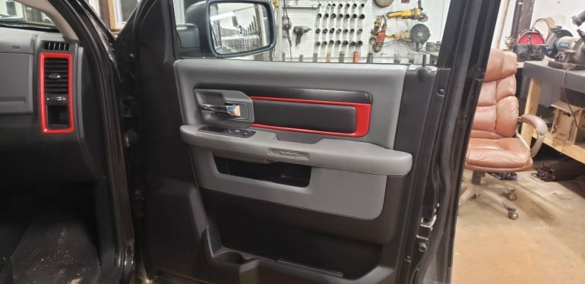

So it's been a while since I've had time to mess with my truck, but I've made some more changes! I wanted to match the door panels to the dash, but was a little intimidated by the plastic welds holding everything together. It wasn't as bad as I thought, a little time consuming though.
So here's the results:
Before:
After:

Did you cut off the plastic welds and then mount them again with screws?

Looks AMAZING. Always wondered why an aftermarket company hasn't come up with something to put over the top to bet rid of that stupid chrome that blind me every time the sun hits it.

Thanks! I was trying to see how other people did theirs, but it seems that it just isn't a common thing to do. I guess that might also come from the fact that to get the best results, you need to undo the melted plastic tabs to separate the pieces.
Anyway, did you do any wrapping on your door panels? I'm still trying to figure out how much of the center trim rings come apart. That's assuming you drive a 13+ with the newer style door panels.

I used a high heat soldering iron that has flat/ wide tips for melting plastic to melt everything back together. I just used a drill to drill the centers out to get the pieces separated.
