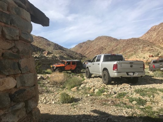

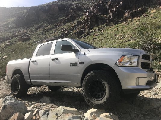

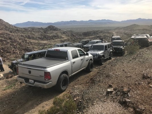

I'm in Trabuco Canyon,CA and hopefully we'll start hitting the bumps in Ocotillo wells or Joshua Tree soon. Darn Covid crap ruined everything this year. I go out with a small group of Toyota Tacoma owners sometimes and those fackers love to go fast, or with my old Jeep Wrangler group and they go very slow, but they do more rock crawling and i only take the truck on the easy trails they run. You have to have rock sliders at the very least on what they call "easy" trails :) around big bear, Joshua tree, 29 palms etc.
For example, This is my local Jeep group, i ran this trail with these dudes, didn't have sliders then, it was alsmost a hard lesson to go out without rock sliders lol
There are areas in this trail where you can nail 40-70mph easy with the Kings even at 34psi. This is where i did my Kings break-in
