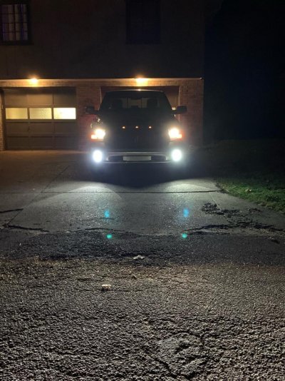

I just installed hikari led fog lights, 9006 size and they won’t come on at all.
2016 big horn. Vertical, halogen fogs came stock.
I have alpha obd and changed the fog light dropout to “NO” and selected “YES” to LED fog lights present.
Is there another change I need to make?

Some LED's are polarity sensitive, silly question, but did you try to turn them around in the socket ?

I did same thing and i had the polarity reversed. 50/50 chance on both bulbs and I had them
Wrong lol.

Glad it worked, looks good. Now it looks like you need to to upgrade your headlights as well. I know, it never ends..
I’ve got an innovited hid kit sitting at the house, just haven’t gotten to it yet.
but then the grille lights are amber and don’t match the heads/fogs...

But the grill lights do look nice in amber.
I installed the HID kit...H1 4300k 55w innovited. I picked 4300 hoping they’ll cut through inclement weather more efficiently but they don’t match up well with the fogs.

I think one of the light vendors, or another member might be able to give some advice on matching up the color.
