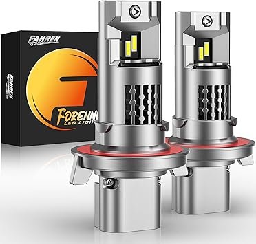

Bulbs are FAHREN Forenner H13/9008 dual beam bulbs:
Forenner Fahren 2023 Upgraded H13/9008 LED Headlight Bulbs, 24000LM Ultra Brighter, 1:1 Size Hi/Lo Dual Beam H13 9008 LED Bulb, 6500K Cool White, Direct Installation, Pack of 2, Fog Lights - Amazon Canada
Forenner Fahren 2023 Upgraded H13/9008 LED Headlight Bulbs, 24000LM Ultra Brighter, 1:1 Size Hi/Lo Dual Beam H13 9008 LED Bulb, 6500K Cool White, Direct Installation, Pack of 2 in Fog Lights.

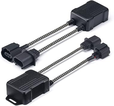

CANBUS harness is a Xsprite H13 CANBUS harness:
Xprite H13 LED Headlight Canbus Anti-Flicker Harness, Bulbs Resistor Decoder Error Free Warning Conversion Kit (1 Pair), Ballast Resistors - Amazon Canada
Xprite H13 LED Headlight Canbus Anti-Flicker Harness, Bulbs Resistor Decoder Error Free Warning Conversion Kit (1 Pair) in Ballast Resistors.
