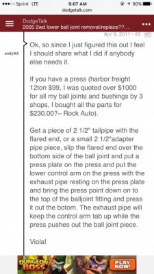

My 03' Ram 1500 started sqeaking hard on every little bump. After some research I found it to be the balljoints(along with the quick look I took at them an saw that the boots were completely torn off. I went to get a quote that came out to being 500-800 depending on where I went. So i decided to order the parts($75 for regreasable ones from Amazon) and do them myself. After watching many videos of people struggling with it I stumbled upon this. Hope it helps anyone in the same situation!

They're pressed in, the only way i've ever seen them removed besides this method is with a universal ball joint remover, they dont have the correct fitting for the joints so using the kit you have to mess with different fittings an such to find what works
