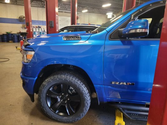

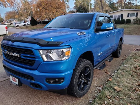

Ok just another couple questions and an update. I just got a set of OEM Sport rims from another Ram owner (black 5 spokes) and put Nitto Ridge Grapplers 305/50/20 on them. Tires stick out of the wheel well by about a half inch, so Im going to put a small 1" spacer behind the wheels. Also got a 2" leveling kit on top of the struts now. I want to do an airbag suspension instead, that way I can lift and drop the truck whenever I want to. Im torn between a suspension upgrade and the airbag kit though...what would be the better option? Both upgrades sound like they would be just as expensive as the other. Other question - what are some good wheel spacers to get for the truck? Something that wont break the bank, but still worth every penny to get. Ive been looking, but I see a lot of stuff out there that looks nice but cost an arm.99 for a pair, and Im needing 4.

I don't get the tires sticking out look, especially throwing rocks and mud up the side of the truck and at other cars but hey, it's yours.
The only spacers I'd trust are Bora Wheel Spacers.
Nov 20, 2018
65
Riverside California
2018 2wd
HEMI 5.7 Revolution 4.88s
Bora spacers is what to get ... I don't trust others at all, I don't even trust spacers period, but Boras I have had on other vehicles in the past ...

As for the actual need for spacers, Im not going too far overboard with them. Ordered some 1" spacers. First off, Im putting fender flares on my truck soon. Tires that stick inside the wheel wells look silly to me; I did that with my 2016 Ram a few years ago and I thought it looked idiotic as none of the lines looked right. Im going with Air Design offroad package - fender flares, rocker panels, tailgate panel...the works. I got the leveling kit installed today, but next week Im going to price out an air ride suspension install. Really liking how its looking and driving so far.
