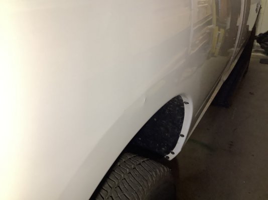

Now on this picture (below) ...it's an easy one: A rock got thrown up and is wedged between the inner wheel housing and the outer skin. Probably with the pointed part of the stone facing outward. The inner fender tapers down to a very small gap of about 1/8" ...between the inner and outer panels. So vibration and such causes the rock to get worked down, even causes an outer dimple. I cleaned the rocks out of my trucks inner wheel housing last year (to do undercoating) ...and got quite a lot of rocks and debris out.

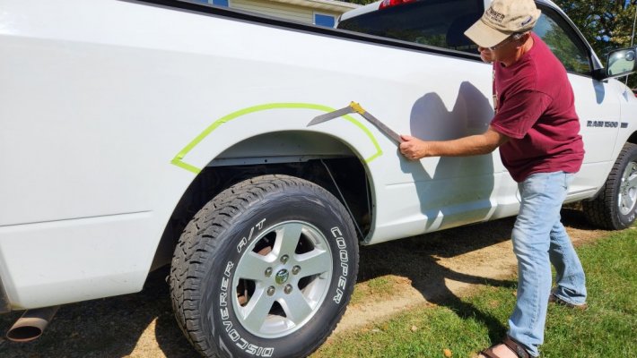

BTW, Below is a pic showing a simple tool i made out of 18ga with a rounded nose. The pic shows how (where) to clean the stones out of the rear wheel wells. You have to get the tool between the inner/outer panels. The rocks wedge in there pretty tight. Remove the rocks/gravel/sand/dirt ...wash thoroughly, let dry, apply oil (fluid film hangs ....won't flow through ..there's seam sealer on the wheel lip. Use oil). This is mostly for the rust-belt owners ...lol. Its work. A guy could just squirt oil up there, but it's best to get rid of the dirt/sand and gravel. The green tape shows the outline of the inner whee housing.
