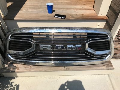

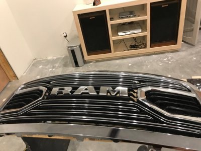

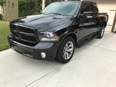

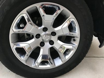

The original owner of my truck sprayed most of the chrome with plastidip. I am going to sell the OEM grille so I wanted to remove the plasticdip first. I sprayed the grill down with WD40 and let it sit for a few minutes and then hit it with the pressure washer. That did a good job of getting it started but then I had to go back through and pick it off by hand. Once that was done I started on the wheels using the same method. With the wheels I did 2/3 rounds of WD40/wash/pick. It was a hell of a process and took most of the day but I am happy with the results. There are still some black spots that I will have to work on a little over time. Before and after pics below.
The Limited trim pieces running down the side and across the tailgate are still plastidipped but it appears to be holding up pretty well so I'm leaving it for now and debating on adding another coat or 2 on top of whats there.
I've got a cross-hairs grill that will be going back on the front once the paint is touched up. For the wheels I'm thinking about having them powder coated black or replacing them with a set of black aftermarkets. If I go with the powdercoat I think I'd like to get all the machined aluminum coated matte black and get the chrome areas in gloss black. I liked the look of the plastidip but it was starting to peel so it was time for something new.
Before:
After:

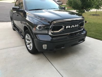

I got the grills swapped out tonight and finished up the plastidip removal on the limited grill. For anyone following along the last step was to use rubbing alcohol and a microfiber cloth to clean off all the gunk and residue left by the plastidip.

Thanks! Ive got a little plastidip left over in the creases of my wheels so I will try goo gone to get the rest of it.
