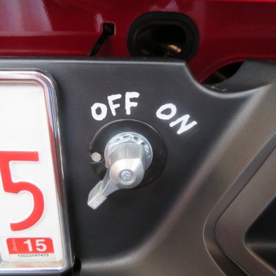

My truck sits all winter long with the battery disconnected with no issues with the tune / radio or truck itself . I'm also in the habit of turning the master disconnect switch off anytime it's going to sit for more then a couple days,which kills battery power to the truck
