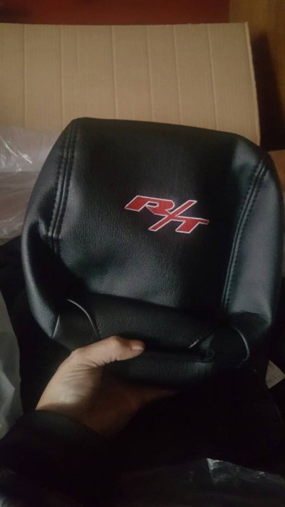

Here's a picture of the custom headrest embroidery I had done:

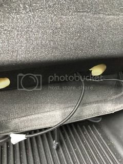

Here is the wire I was referring to. I cut a slit to allow the wire to be pulled straight across the lower back section. I did not want to disconnect the wire due to the air bags and had no interest in disconnecting both batteries.

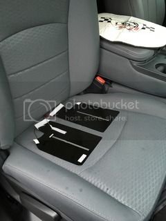

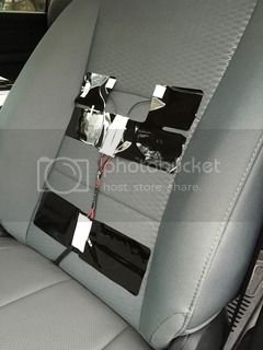

Next are the seat heaters stuck to the original upholstery:

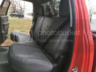

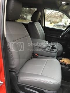

And here are some completed pics:
I still need to cover the jump seat and figure out how to mount the heater switches. If I were to do this again I would use the Metra kits. If this setup does not work out they will get reworked next summer.
